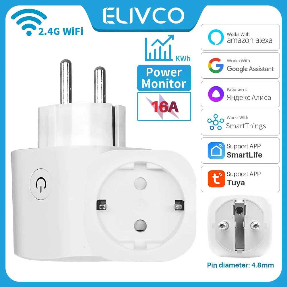

Setih se da već imam kući jedan taj smart socket sa merenjem potrošnje.U zavisnosti koju aplikaciju koristis , imas vise razlicitih uredjaja:

Tuya WiFi Smart Plug 16A/20A EU Smart Socket With Power Monitoring Timing Function Smart Life APP Voice Control Via Alexa Google

tuya 16A,20A Smart Plug WiFi Socket EU Power Monitoring Timing Function Works With Alexa, Google Home, Alice, SmartThimgs - AliExpress 44

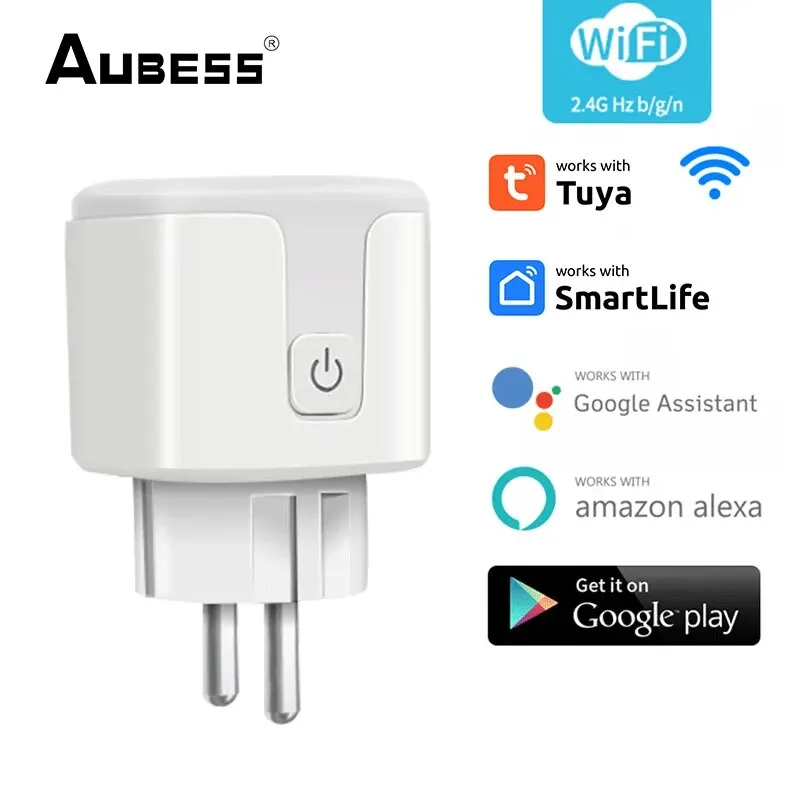

Još su pale cene ima i 20A verzija ista cena
Just found this amazing item on AliExpress. Check it out! €4.42 53%OFF | eWelink 16A,20A Smart Plug WiFi Socket EU Power Monitoring Timing Function Works With Alexa, Google Home, Alice, SmartThimgs
