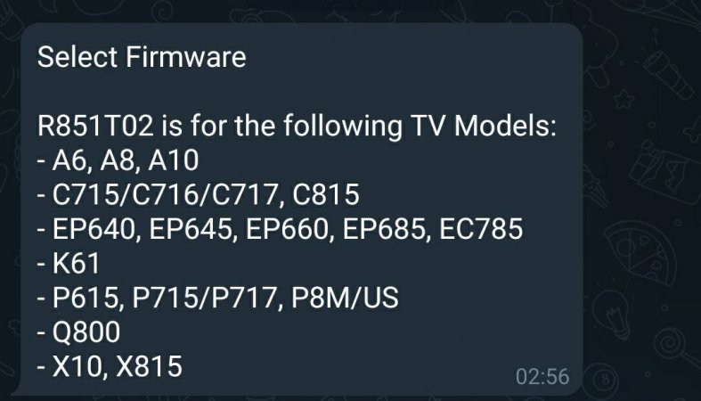

Posle dužeg vremena novi firmware V660.
New TCL R851T02 Android TV Update available in V660 IMG file
V8-R851T02-LF1V660.019318
V660 IMG File:
build date= Nov 15 2021
build= 1636990472
security_patch= 2021-01-05
gmsversion= Android_9_Pie
software.version_name=AP08
IMG size= 3.00 GB
Da na pomenen da je .img fajl tako da je instaliranje drugačije od OTA fajla.
HOW TO INSTALL
OTA
1. Download zip
2. copy zip to USB Drive (FAT32)
3. plug it in TV (preferably USB 2.0)
4. in the settings -> update -> choose local update
1. Download zip
2. unpack zip (sometimes it contains one IMG file, sometimes some files in it) & copy to USB Drive (FAT32)
3. plug it in the tv
4. shut down the tv
5. then press & hold the power button on the tv (not remote) for 5 seconds until it is flashing and wait for it to be installed.
