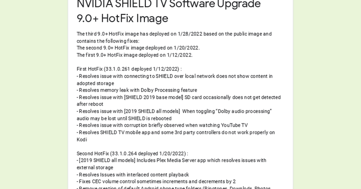

Иначе, за оне који нису испратили ово за први фикс који се добија на упит уносом СБ-а од бокса, ево адреса
и директно на гугл

We are working hard to deploy the 3rd Hotfix on friday 1/28/2022. Keep an eye out for it over the next 24-48 hours.
Third HotFix (33.1.0.271) deployed on 1/xx/2022:
  • Resolves Wifi disconnects on a subset mesh/band steering network setups
  • Resolves Plex file access issues which requires users to set up Plex server again after OTA upgrade
  • Resolves issue while using Bluetooth headphones, audio is routed to HDMI instead of headphones only when audio formats is set to Manual
  • Resolves free space reports incorrect using SMB server feature in SHIELD
  • Resolves issue when switching the input away from SHIELD via CEC, SHIELD does not sleep
  • Resolves issue copying files over SMB to SHIELD while an app is running on SHIELD can lock the SMB transfers out
  • Resolves long press menu button and menu button push to Kodi not working
  • Resolves SHIELD screen gets rotated 90 degrees
  • Resolves mouse click not working
  • Restores ability for SMB server to navigate Kodi media files
