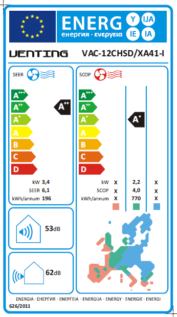

Venting su obe bile one crne 12tice, sto imaju LCD monohromatski pokazivac temperature na njima, wifi modeli
Ako sam lepo nasao, ove: VAC-12CHSD/XA82
