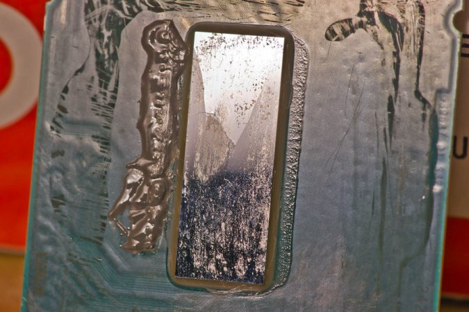

Kako je to puklo, pobogu? :S:
Izgleda da su na nove batcheve poceli stavljati super lepak. :d
kako je pukao niko ne zna, zna se da ima vec par ljudi sa puknutim cipom, najverovatnije kad su vratili ihs pretegli su heatsink i to je to.
nije se odmah desilo nego posle mesec dana koriscenja
Čoveče, ne mogu da verujem da je puklo, ti baš imaš peh za pehovima.
Pa kakve sad planove oko overkloka imaš, Kikibbgd ? Koliko vidim, posle ovog lošeg iskustva nešto ti se ne da da ponovo ideš istim putem, jesam li pogodio ?
@ Kosta
Nije to njegov cpu....to verovatno shabani direktno shibaju kulere na die,zato se i desava da pukne,mozda ne odmah,ali prilikom nekog duzeg zagrevanja samog die-a,verovatno sam materijal od cega je napravljen se drugacije pocne ponasati pa pukne.....i ja sam cuo za taj EK blok-kit sta vec,koji ide direktno na die,tu nema dileme,najbolja varijanta,i nemas brige da ces nesto *******,jer je verovatno sve odradjeno precizno u stoti deo milimetra....naravno,pod uslovom da imas vodeno :)

I have had many discussions with managers at Intel about the reasoning behind the TIM instead of solder like sandy bridge. Stig said it was because that they were cracking the dies and killing them. He is completely correct, they said for some reason with the high to low load tranfers of heat that the die would slowly crack over time.
I asked then why the reasoning for some much glue to hold down the IHS. They said it was because with the fluxless soldering on sandy bridge it actually helped hold the IHS on. Which makes sense because if you ever watch a delidding of a sandy bridge and they torch them off they literally pop right off the die when the solder is warm enough. I bet you they were forced to use more glue as more of a precaution to keep these IHSs on for their customer "us" so that trying to takke off a big bulky heat sink and the latch can sometimes were at the bond in the glue and make the IHS simply come off.
Im actually impressed Intel went to so much trouble think about it. They would have had to completely redo their assembly lines and manufacturing processs to make their product perfectly usable. An as a business major that's perfect sense, as you have limited time to redo your process and give enough of these out to sonsumers before the launch. You have to give them credit for that.
The grey "goop" TIM they used is pretty good I've found it once a while back and I need to try it.
Now with the newer ivye chips and the fluxless soldering on those bad boys.
1. Different socket different die size.
2. Die must be bigger to take the 2011 motherboards orders and such including twice the ammount of RAM as its 1155 brother.
Kako to da je IB-E imun na ove probleme? Logicno bi bilo da koriste isti TIM metod i na IB-E procesorima posto je mnogo veca steta ako skuplji die "napukne".
verovatno je drugaciji die, i bilo bi glupo da na procesoru od 500e koriste isti fazon
Slazem se, bilo bi glupo to raditi na IB-E, ali je isto glupo sto koriste pticiji izmet na procesorima od 300e. :) Da su koristili neku bolju termalnu zvaku/pastu, ne bih imao primedbe.
Tako da ono gore citirano je samo polovican izgovor Intel-a.

anandtech je testirao negde ne mogu sad iskopam glavni problem je odstojanje procesora od ihs-a zato je temperatura visoka.
ko je kupio sb-e na pocetku on je najbolje prosao
evo neke mere
oko debljina itd
Kako lazu, pa to je cudo jedno. Da pucaju jezgra, mislim... neverovatna kolicina oholosti. Namerno su stavili zvaku da ne bi sa CPU-om od 200eur dostigli uz OC na 4,7-4,8Ghz performanse procesora od 500eur (6 jezgara na staroj Sandy bridge arhitekturi). Sta misle da ce me to naterati da dam 500eur za gov*nce staro 3 godine sa njegovih 6 jezgara??? Slepci.
to da muljaju stoji, no kad ce tebi stigne haswell bas me zanima kakav je spacemasterov primerak :) mozda ja pazarim kod njega kad budem dolazio za koju nedelju :)
