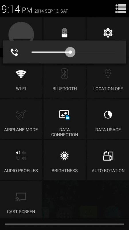

Malo slicica aosp KitKat dok ne obrisem screen capture app
Takođe nemam taj problem
uploadfromtaptalk1410635838599.jpguploadfromtaptalk1410635853533.jpguploadfromtaptalk1410635862507.jpguploadfromtaptalk1410635872363.jpguploadfromtaptalk1410635882709.jpg
