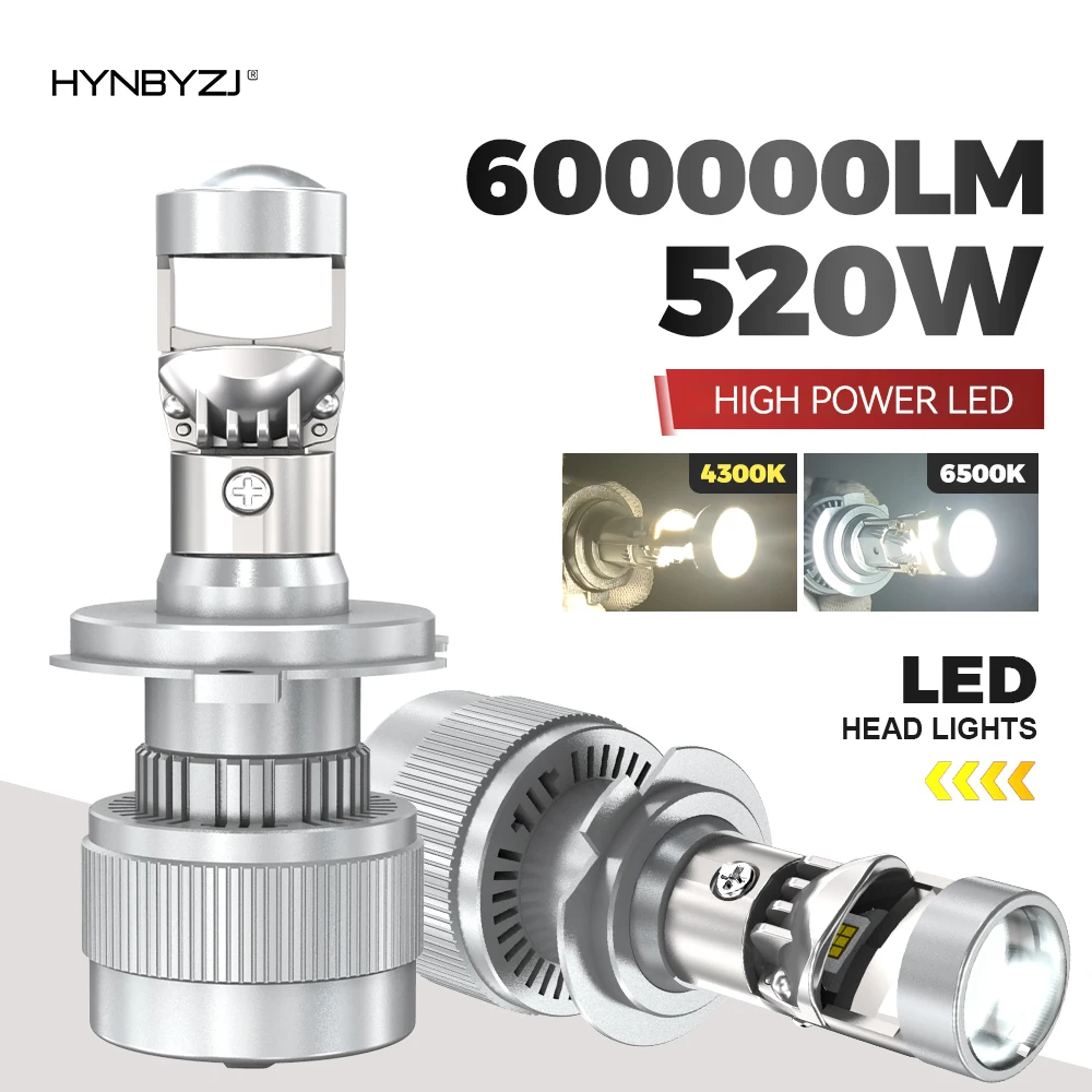

Nađi mini lens H7 od 4300k ako ima. 😁 Ceo Ali ih nema. Bar nije imao pre godinu dana.😁
Bukvalno na prvu 4300K H7

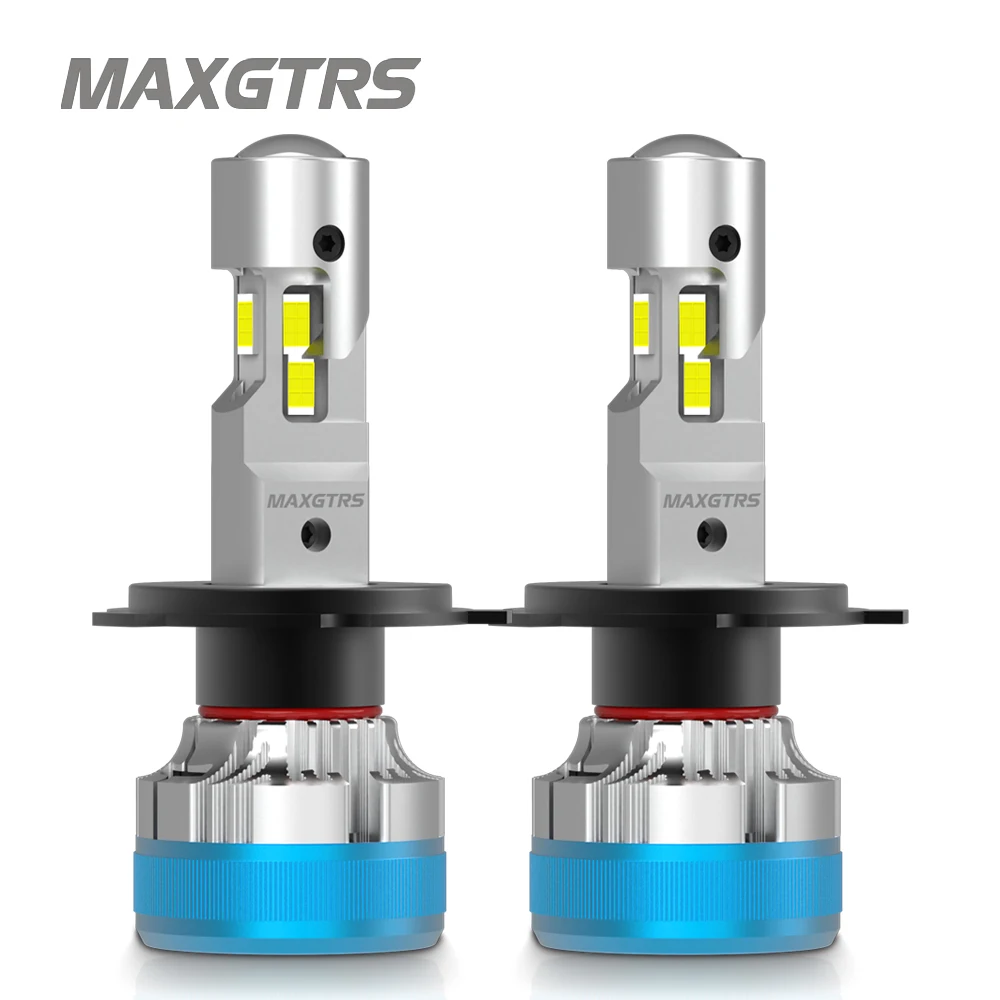

I just found this on AliExpress:
€40.66 | 2Pcs 34000LM Super Bright H11 H8 H7 9005 HB3 H4 LED Canbus No Error Headlight Bulb Auto Lamp 9012 HIR2 LED Head Lights Lens
Nemoj pricati da nema ima koliko hoces i nije Ali jedino mesto pricas coveku koji se bavi time preko 20 godina.
Uglavnom dokazao sam ti da i na aliju ima.
Cuj ceo Ali ih nema, pis zivi😂🥱

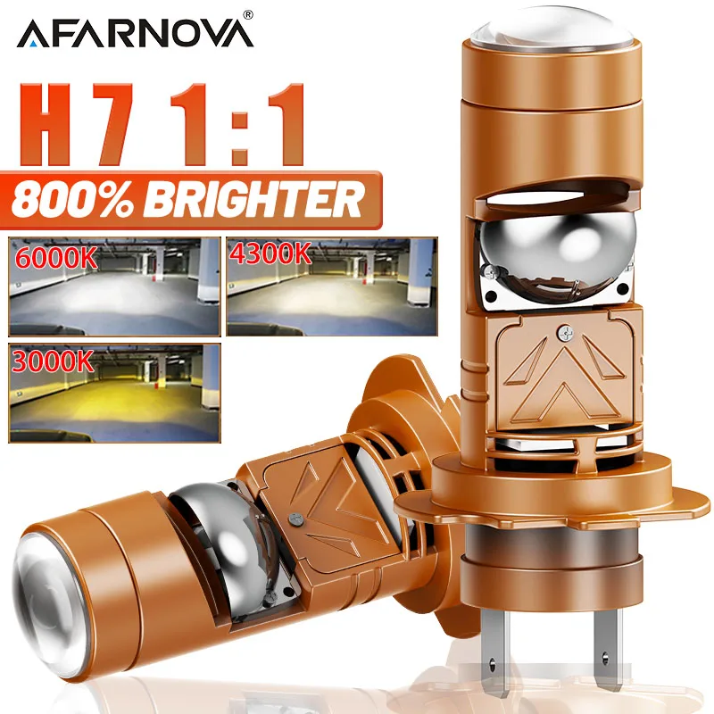

€19.00 | H7 LED Projector Car Headlights 3 Color Canbus Wireless 3000K 4300K 6000K Auto Fog bulbs Plug&Play Mini Lens Projector Fog Light
€48.39 | HYNBYZJ 4300K H7 Mini LED Projector Lens Canbus H11 H4 Auto Headlight Turbo Lamp Automotive Projector 6500K LED lights for Car
