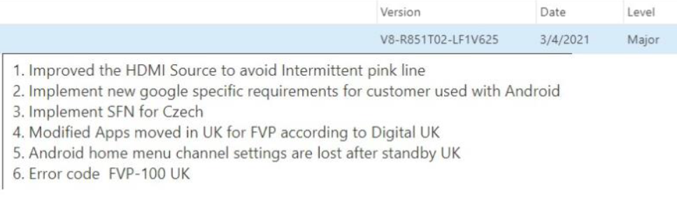

V625/626 official changelog:
Download: http://celesw.tcl.com/CSEU TV/Techn...ebsite TV SW/Update-41 RT51 V626/04032021.zip
