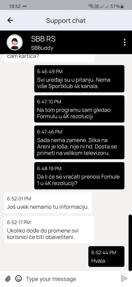

To whom it may concern:
    88.3 KB · Pregleda: 224
