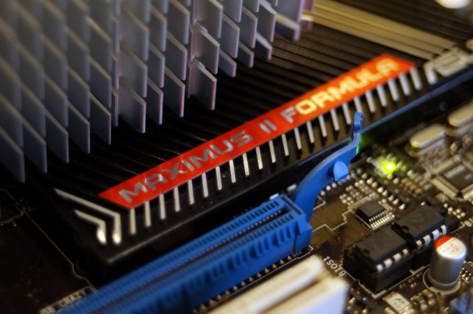

X5470/4.4GHz/1.3875 BIOS V ~ 1.4 LOAD (uključen LLC)
Thermalright TRUE Extreme + T`right 140mm + 120mm neki za push ka T`right NB hladnjaku
Cooler Master E1 IC Essential
Maximus II Formula
Transcend 4x2GB/1066
Gigabyte nVidia GT 610 1GB
Seagate 2.5" 120GB/7200
Aerocool GT-500SG Gold 36A+36A
CPU+COOL+MOBO by 5xeVo cheers
Svi memorijiski slotovi popunjeni. Ništa prčkano po GTL referencama. NB oko 1.35. TRUE pleni!
