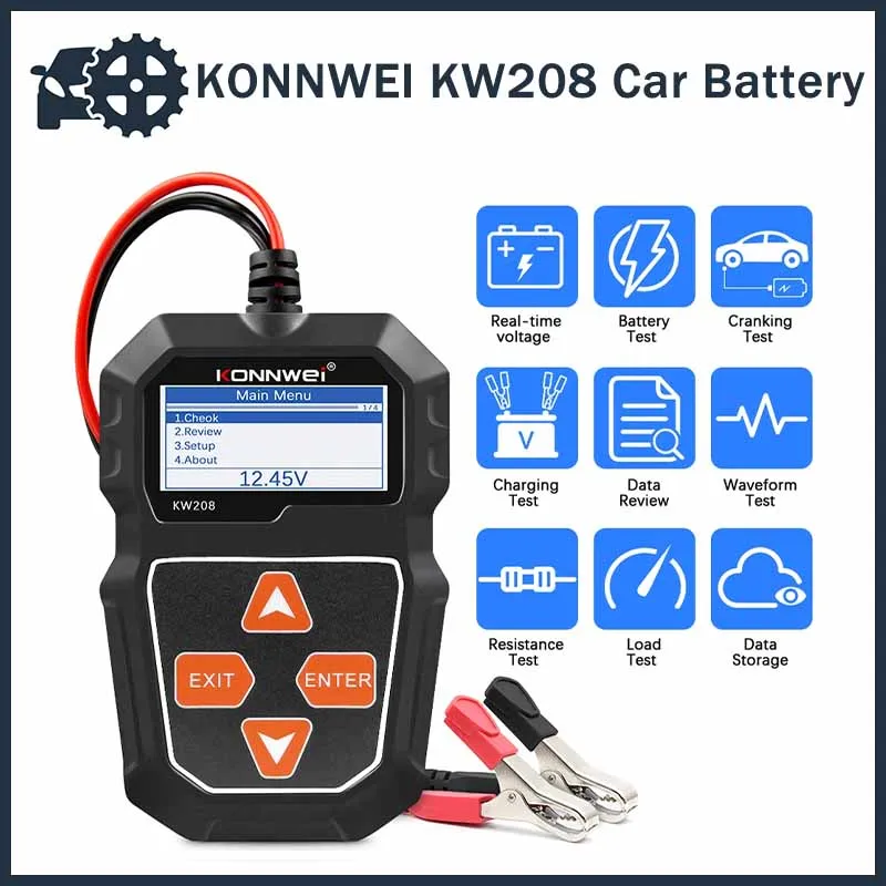

Ima da se kupi tester akumulatora na aliexpress kome treba, ja sam ovaj uzeo prije mjesec dana ali je bio samo 15$.
I just found this on AliExpress:
US $33.11 | KONNWEI KW208 Battery Tester 12V Automotive Battery Charger Inspection Tools 100 to 2000CCA Cranking Charging Circut Analyzer
