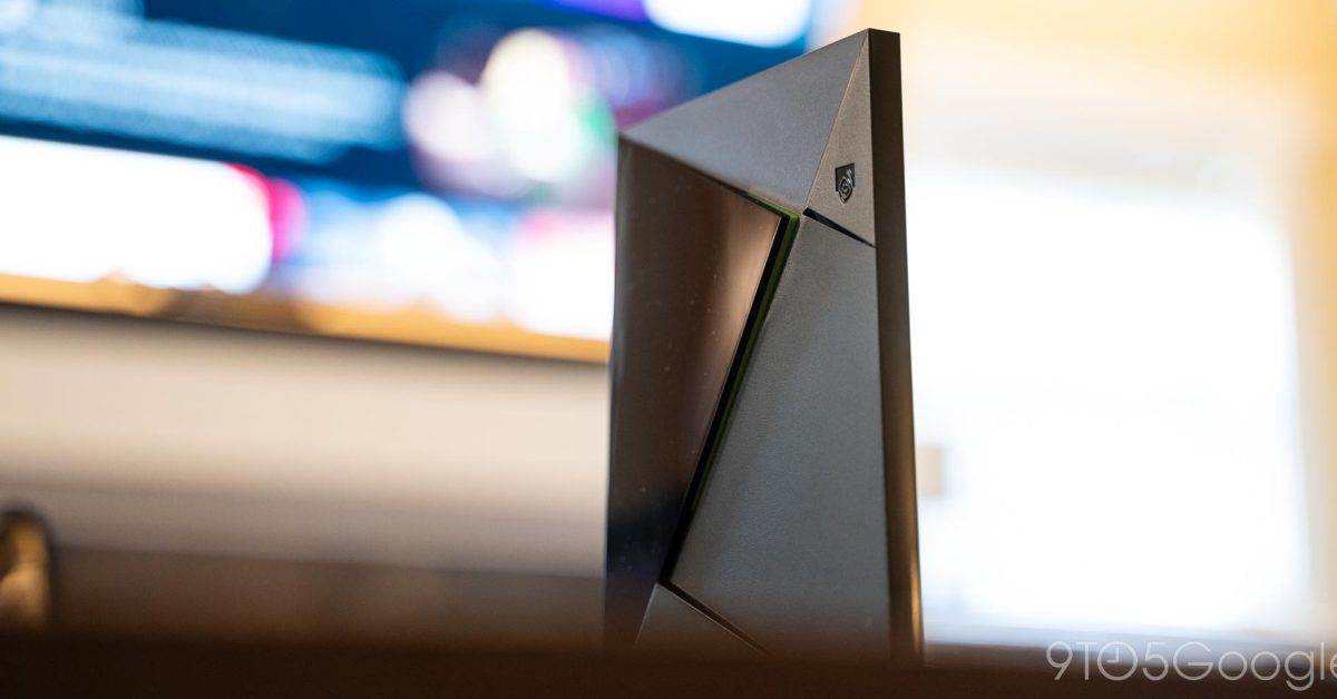

Nvidia still manufactures the 2019 Shield because people are still buying it. In fact, the sales volume has remained basically unchanged for the past 10 years.
Bell says the company has no plans to stop production or updates for the Shield “any time soon.” It’s also still possible that Nvidia could release new Shield TV hardware in the future.
“We’re always playing in the labs, trying to discover new things,” said Bell. “We’ve played with new concepts for Shield and we’ll continue to play, and if we find something we’re super-excited about, we’ll probably make a go of it.”
