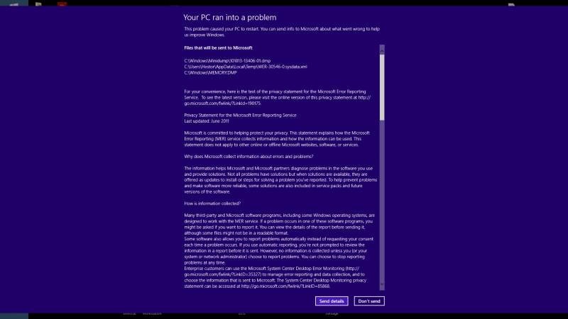

Vec sam nekoliko puta dobio ovaj BSOD:
Evo sta pise u WhoCrashed:
Crash dump directory: C:\Windows\Minidump
Crash dumps are enabled on your computer.
On Fri 10/18/2013 6:55:00 AM GMT your computer crashed
crash dump file: C:\Windows\Minidump\101813-13406-01.dmp
This was probably caused by the following module: ntoskrnl.exe (nt+0x5A440)
Bugcheck code: 0x1A (0x41792, 0xFFFFF683FF77F528, 0x8000000000000000, 0x0)
Error: MEMORY_MANAGEMENT
file path: C:\Windows\system32\ntoskrnl.exe
product: Microsoft® Windows® Operating System
company: Microsoft Corporation
description: NT Kernel & System
Bug check description: This indicates that a severe memory management error occurred.
This might be a case of memory corruption. More often memory corruption happens because of software errors in buggy drivers, not because of faulty RAM modules.
The crash took place in the Windows kernel. Possibly this problem is caused by another driver that cannot be identified at this time.
crash dump file: C:\Windows\memory.dmp
This was probably caused by the following module: ntkrnlmp.exe (nt!KeBugCheckEx+0x0)
On Thu 10/17/2013 7:58:42 AM GMT your computer crashed
crash dump file: C:\Windows\Minidump\101713-17437-01.dmp
Bugcheck code: 0x139 (0x0, 0xFFFFF88018052430, 0xFFFFF88018052388, 0x0)
Error: KERNEL_SECURITY_CHECK_FAILURE
Bug check description: The kernel has detected the corruption of a critical data structure.
BlueScreenVIew SS:
