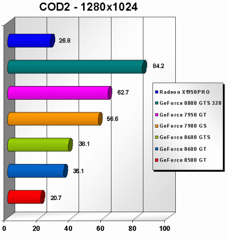

Nisu se proslavile u CoD2
    44.7 KB · Pregleda: 78

Odlican test, kroz sve rezolucije, a narocito zanimljivi rezultati u 1280x1024. 8600GTS tesko da se moze smatrati "pametnom" kupovinom. U pola testova je dosta losiji od 7900GS, a u onoj drugoj (shader intenzivnijoj) polovini je slabiji od x1950pro. Kosta cca 200eura, tj. 20 eura vise od x1950pro i oko 35eura vise od 7900GS. Mislim da 8600GTS ne opravdava ocekivanja. Mislio sam da ce biti bolji, ali nazalost nije. :trust:
Prosecno se overklokuju 10-12%, kako za GPU, tako i za memoriju. Cak i x1950pro se overklokuje bolje od ovoga, a o 7900GS da i ne govorimo.
"I think everybody expected the 8600 series to perform better in games. The GT is merely 15% faster than a 7600 GT in most scenarios; with the GTS performing at roughly 7900 GS or Radeon X1950 Pro performance. A Radeon X1950 Pro or 7900 GS for example will outperform the GTS in many scenarios and is a good amount cheaper. I can pick either one of them up here in the Netherlands for 150 EUR. Sure, these cards are not DX10 compatible but I think you'll see a lot of reviews today with exactly the same sentiment. Yours truly expected more performance. The 32 Shader cores and the choice of 128-bit memory are the responsible key issues here, and NVIDIA knows this. This is why the clock frequencies on the cards are so high."
