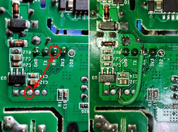

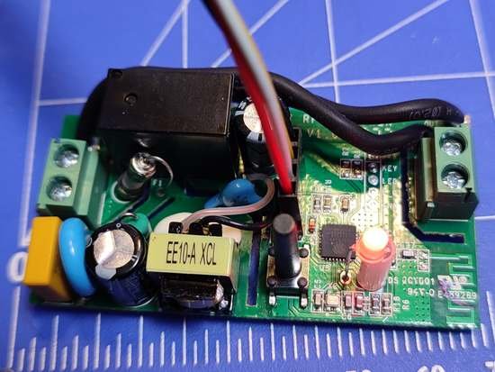

Sonoff Basic R2 Smart Home Switch ima ugrađenu dvobojnu LED. Upotreljena je samo zelena a crvena stoji neiskorišćena.
Ovde je objašnjeno kako jednostavno prepraviti prekidač da se aktivira i crvena LED. Primer je sa ESPHoem firmverom, ali može da s eupotrevi i Tasmota ili bilo koji drugi custom firmver.
pedja.supurovic.net
Enabling two color LED on Sonoff Basic R2 Smart Home Switch
I like Sonoff Basic R2 Smart Home Switch as it is low priced but very functional multipurpose device. Most of all, it contains ESP8266 chipset which means it is
pedja.supurovic.net
