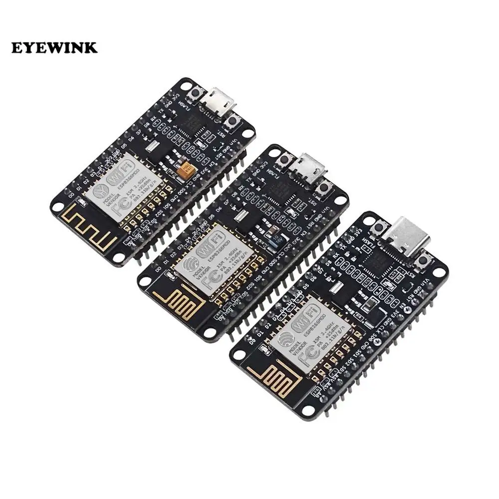

€ 2,39 5%OFF | esp8266 NodeMCU v2 Lua WIFI networking development kit board based on ESP8266 amica CP2102 ESP-12E/F

https://a.aliexpress.com/_mLmMiTE € 2,39 5%OFF | esp8266 NodeMCU v2 Lua WIFI networking development kit board based on ESP8266 amica CP2102 ESP-12E/F

Gledajući video uputstvo ovaj NodeMCU sa odvojenim pinovima je poželjno uzeti, ako se ne varam?
