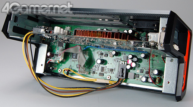

neki su trazili link
Asus XG Station
external graphics card pimps your laptop's graphics LINK
The XG Station connects to a notebook via the ExpressCard

inside: ASUS EN8800GT 512MB GDDR3
http://en.wikipedia.org/wiki/XG_Station
XG Station
The ASUS XG Station is a device designed to provide external graphics processing power to laptops. It connects to a laptop though an ExpressCard slot. It will require a separate monitor as well as its own power source, both of which reduce its viability for portable gaming.
It includes a large knob used to control various settings such as overclocking, USB 2.0 ports, and a headphone jack. The screen tells the user information such as the GPU's clock and memory speeds, fan speeds, temperature, master volume, and FPS. From available photos it would appear that it will also provide dual DVI output connectors.
The XG Station was featured at the 2007 Consumer Electronics Show. Neither the price nor the release date are determined.
The XG Station was scheduled to be released at the beginning of Q2 2007. It is currently unknown if it is still intended for release or has been cancelled. A full package will include the XG Station graphics docking station, one ASUS EN7900GS graphics card and assorted accessories. Asus News[1]
There has been much speculation as to whether or not the standard Asus EN7900GS may be swapped out for a different graphics card. While thus far this does indeed appear to be a possibility, the XG Station's power supply and physical dimensions may be limiting factors.

a slika govori hiljadu rechi:
a cena... oko 600$... cjena - prava sitnica
to je cena u pocetku, svi znamo koliko kostaju graficke kada se pojave , a koliko posle odredjenog vremena, pa prema tome ovo je samo pocetak, bice ovo oko 200e
samo polako, a dolaze i mnogo manji modeli (sa mobility cipovima)
da... ali i dalje nije resenje... cemu poenta jace graficke karte za koju moras da imas napajanje i monitor ?!?
